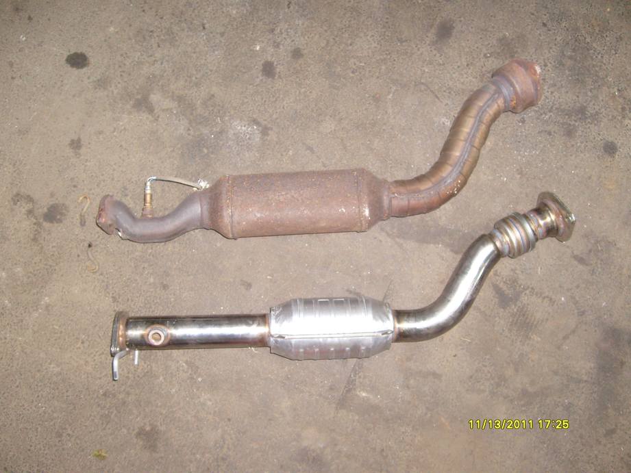

The downpipe wouldn't cause a MAF error. Nor, would it cause the engine to run lean.
An EFI system is a closed loop system with the oxygen sensor as the main feedback sensor. GM PCMs have no problems going over +/-10%.
In reality, your downpipe does little. If anything, it hurts low-end HP. And, it likely helps with a little more HP over 3K.
Any gain will be seen when replacing a cat with 40K+ miles.
There have been many dynos runs done with different size exhaust systems and with/without cats.
Often, people believe BS more than they believe real data. And, BS is what sells ****** products, and makes money for these companies. Then again, if people want ******, why shouldn't the companies sell it to them? :)

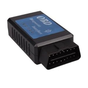

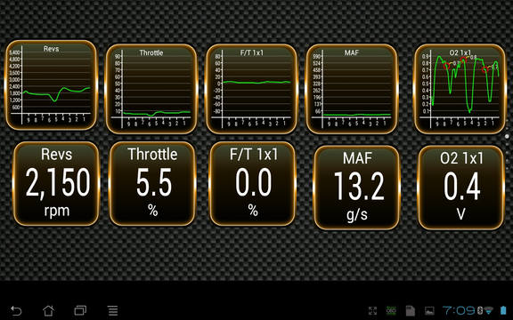

If you have an Andriod, iWhatever, or laptop, you can use a cheap bluetooth OBD-II connector. Below, I have pictures taken with my 10" tablet and the free version of the Torque program. I have the paid version on my 7" tablet.
The update rate isn't very fast. Still, it's a few times per second.
It displays only some of the real-time data. And, IIRC, you can't clear error codes.
But, it's cheap, and it does offer a lot of functionality for a very low cost.. :)
If your laptop doesn't already have bluetooth, you can buy a cheap USB to bluetooth adapter.

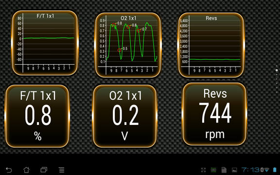

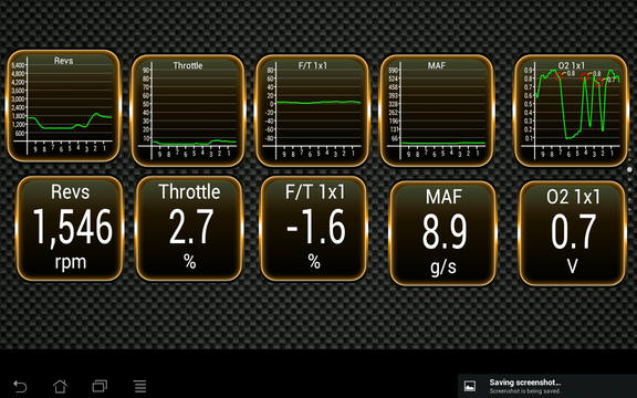

The forth picture with just three graphs shows what the O2 data should look like.
Sample rate, etc is what effects the O2 graphs in the first three pictures.
BTW, "F/T" is the fuel trim for that rpm-range/load-range cell. It may be the short-term trim. I forget.
Read the help file/web site for more info. :)

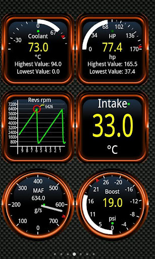

Here is what I have on my Android tablets:
Android 4.x
http://www.amazon.com/gp/product/B005NLQAHS/
BAFX Products (TM) - ELM 327 Bluetooth OBD2 scan tool - For check engine light and other diagnostics - Android compatible
Price: $23.99

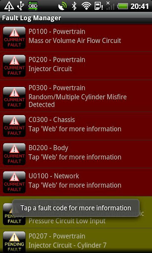

Here's the paid app that I have: $4.95 on my 7" table, and the free version on my 10" tablet:
jCmUBkfai1vJhnCYXDefs706hLCrBAPtzDX4JI4aFuVza2MS-ZMSSJnJFSFEHciDU9s=w124
Torque Pro (OBD 2 & Car)

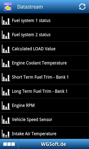

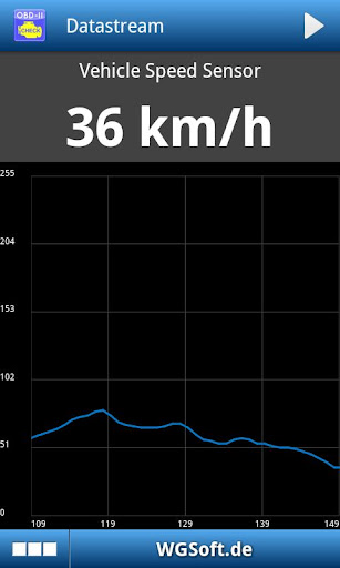

Here's a free app that I also have:
I didn't check to see what parameters it did read, and the update rate.
e-hDdxLVjIMxINLP2D_FaOFJNQEaZ3fyY3XJb7oQAWFL47d1EIVUefUJZH3ncgliZGM=w124
https://play.google.com/store/apps/details?id=de.wgsoft.scanmaster
ScanMaster Lite is an application for vehicle diagnostics to OBD-2/EOBD standards. It "transforms" your Android smartphone or tablet to a vehicle diagnostic device. Many important OBD-2 functions are despite "Lite" available without restriction. Only the number of parameters and error codes are limited compared to the Pro version.

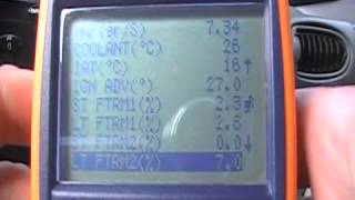

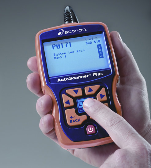

You can get an Actron CP9580A from ebay for ~$140. Amazon has them for ~$180.
Below is a list comparing the Actron products. The list is from the Amazon web page for the older Actron CP9580.
Actron CP9580A

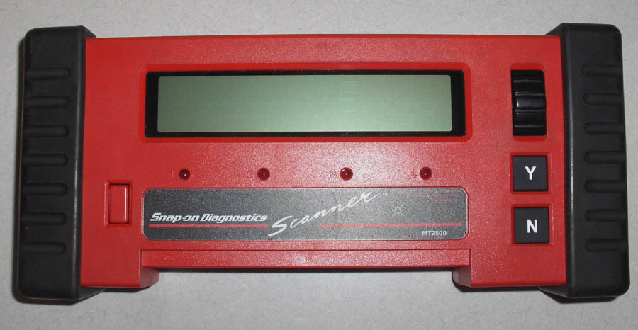

If someone does want something with the ability to do many of the factory tests (like turning off an injector for testing), and they don't want a GM Tech-II clone, or to pay the $~2K+ for a used real GM Tech-II scanner, then a suggestion from another GM forum is to get the Snap On MT2500 or the Snap On MTG2500 scanners. The MTG2500 adds the ability to show data in a graph form. But, they do not come up on ebay that much.
A Snap On MT2500 kit often sells on ebay for under $400. Make sure you get the modules that cover your car(s) and years!
I think that some of the standard GM modules go up to 1999. That might work for a 2000+. But, I doubt that it would have any AIR System parameters.

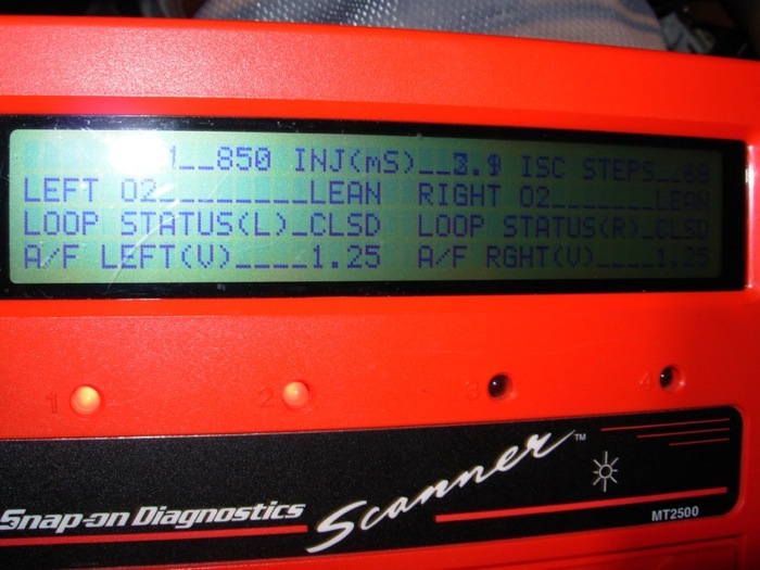

BTW, I do not know for a fact that the snap-on scanner does the injector diagnostic tests/etc on a W-body GM platform.
IMHO, being able to do a CPS (Crank Position Sensor) recalibrate or a steering wheel angle recalibrate is a very good thing. Those are the main reasons I got the Tech-II clone.
My guess is that the Snap On MT2500 does do those tests. IIRC, someone had a Snap On MT2500 in this forum, and I think they sold it someone else in this forum. Maybe they can chime in, so that we know for sure. :)
Yes, the PCM and engine will likely "run" if someone doesn't do a CPS recalibrate with a new CPS or a new/used engine.
But, misfires can, and likely will, happen at high rpms. There will likely be "misfires" at high rpms without doing a CPS recalibrate. But, they'll likely be "minor" and hopefully will not add to the POS heads eventually blowing the head gaskets.

Snap On MT2500
Ebay search links for SnapOn MT2500:
http://www.ebay.com/sch/i.html?_nkw=Snap+On+mt-2500&_dcat=43989&Tool%20Type=Kits%20%26%20Sets&rt=nc

FWIW, I also went a new cat and with a bigger downpipe and one that did not have the "U" bend. And, I'd do it again without regret! Like with my Mustang, if I lose ~3HP below ~1K rpms, then BFD. :) I'd rather have the better flow, and hopefully better gas mileage, on the highway.
Also, IMHO, *I* would rather have a few more HP in the higher rpms for better passing. :)
